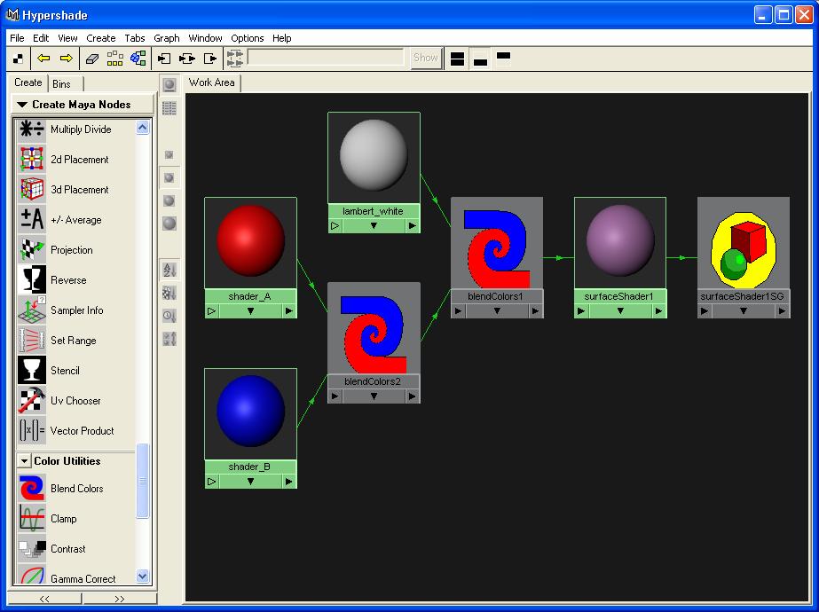

Light is falling = shaded color of a light interacting shader. Eg a shaders output. Ergo anywhere theres color on a lambert shader there is light shading ergo its non 0. Not taking any consideration on what kind of transfer function you want, however if you have a image of earh your really want to use a more Oren-Nayar like shader, anyway you can just pump the value and clamp the lambertian spread.
Now the blend node is easy here it has 3 input slots.
blender
color1
color2
Blender is just simply a value form 0 to 1 then output is blender*color1+(1-blender)*color2 ergo a linear interpolation. Now choosing a shader for the texture slots. Now dont go connecting a shader that lights itself in the slots because then youd get black in the shadow anyway. (black in lambert is also black in a blinn remeber)

Now like i said you can use a ramp node isntead of clamp if you need more esoteric transferal of the light of lambert1. Alternative 2: if you have more than 1 image use a ramp instead of blend, and connect outcolor of light catcher to the u and v of the ramp. Then make as many color slices as you need and map the textures to the color ranges
