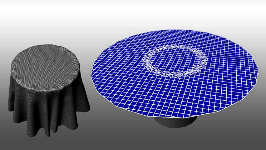

From the screenshot you've provided it looks like you may want to add a new edge so that it bends perfectly at that specific location. Although you CAN get results with just a quaded sheet, it will then give you the problem of having a kind of "lump" before flowing over the edge of the object without edges there. To further that effect, you can actually make an area around that specific location that you want to crease a little better once you smooth it (both these images use that).
