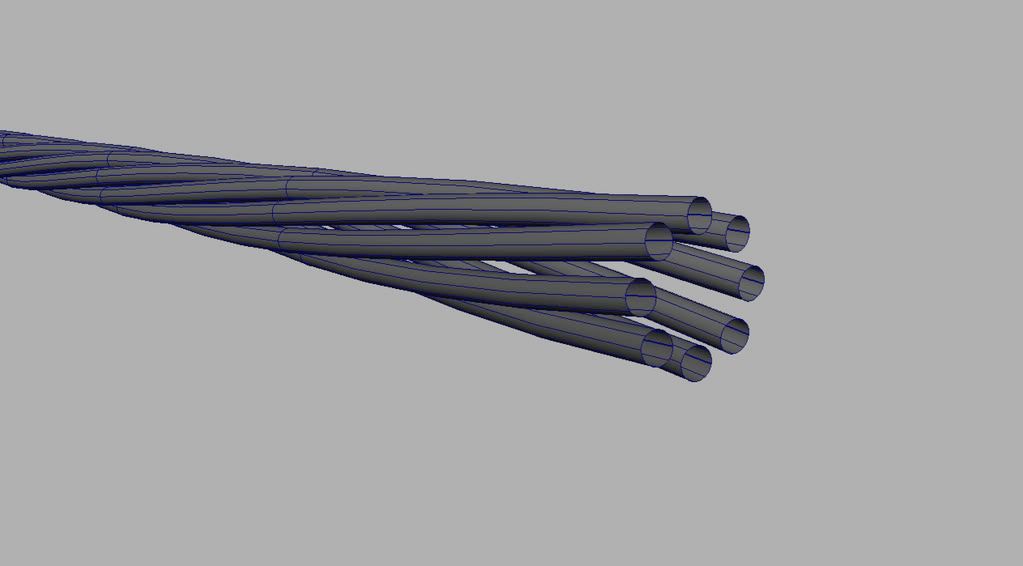

yea thats a pretty good solution. here is my example work in progress... its not quite fully dynamic yet.. but im hoping to build a UI for it as well as be able to detect surfaces and curves better... but in the mean time here is the working code.
so far it doesnt extrude curves but just makes the helix curves around a source curve. but in the mean time i have to make a nurbs tube manually around the source curve then run the script.. im working on a good extrude tube proc that i can call that will make all the tubes for me automatically
