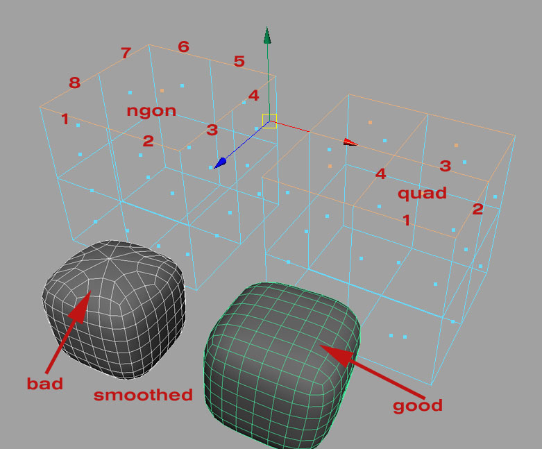

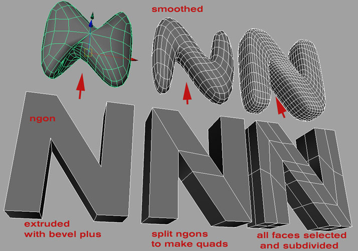

You'd have to show me the wireframe as well but I suspect that the top surface is an ngon and that is why you get the undesired results when you try to smooth
what do you mean by the word ngon? not completely familiar with that term.
It means a polygon with nth nunber of sides to it.. usually referring to a polygon with 5 or more sides. It you want mor epredicatable result syou will need to use the split polygon tool to divide the ngon up into quads so that it connects venly to the edges of the surrounding sides.
